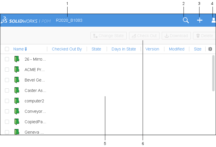

| 1 |
Current vault path
Displays the current path of the file or folder list or the file detail view. You can click a folder name or vault root to change the path. |
| 2 |
Search |
Lets you search from the current folder, subfolders,
and all folders. |
| 3 |
File action |
Lets you create a new folder, check in files, or
check in file structure. |
| 4 |
User menu |
Lets you:
- Display the name of the logged in user.
- Select the language.
- Access the Web2 help.
- Log out.
| 5 |
View area |
Displays the folder contents, search results, and file details. |
| 6 |
Action |
Lets users with appropriate permissions modify
vault contents and download files. |
