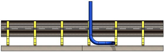

This example modifies an instance of a linear component pattern by moving a
bracket away from a pipe.

![](hav1556891477106.image)

In the callout, modify the value for Dir 1 offset from nominal to -60mm and click outside of the callout.
A shadow instance appears in the new position.
![](xih1556891781373.image)
In the PropertyManager, click
The bracket is no longer behind the pipe.
![](hwi1556891903022.image)
