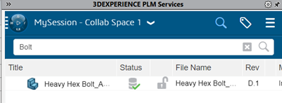

Do one of the following:
- Right-click the model and click Save.
- Open the action bar at the bottom of MySession and click .
The action bar is minimized at the bottom of MySession.
In the Save to
3DEXPERIENCE dialog box, select options,
such
as:
- New
Revision
Increments the revision ID to the
file.
- Bookmark
Lets you add a bookmark to the file using the
Bookmark Editor app.
- Release
lock
after Save
Lets another user
lock
the model after you release the model.
Click Save.
MySession
unlocks
the model and updates the revision.
