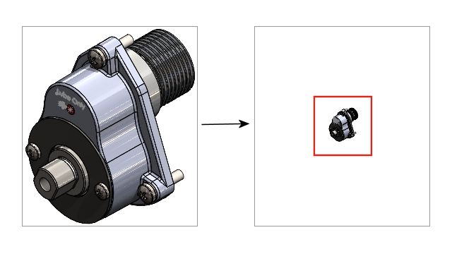

Accelerated Zoom
In the graphics area, you can press Shift + mouse wheel for accelerated zooming.
To use accelerated zoom:
  1. Close all documents.
  2. Click System Options > Display.
  3. Clear Display scrollbars in graphics view for parts and assemblies.
  4. In an open document, press Shift + move the mouse wheel and zoom in or out.
