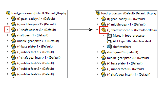

For assemblies opened in lightweight mode, top-level components and
subassemblies resolve automatically when you
click
to expand the item in the
FeatureManager® design tree. Components in
subassemblies remain in lightweight mode until you expand them.
