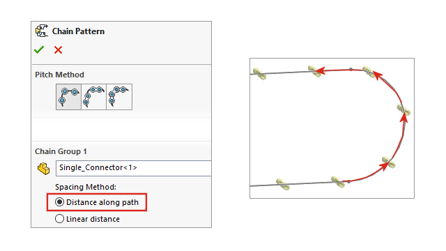

Spacing Options for Chain Patterns You can define spacing between chain pattern instances as a measure along a path for Distance and Distance Linkage chain patterns. In the Chain Pattern PropertyManager, select a spacing method: Distance along path Spaces pattern instances at the specified distance as measured along a path. Linear distance Spaces pattern instances at the specified distance as measured as a linear distance. Parent topicAssemblies
