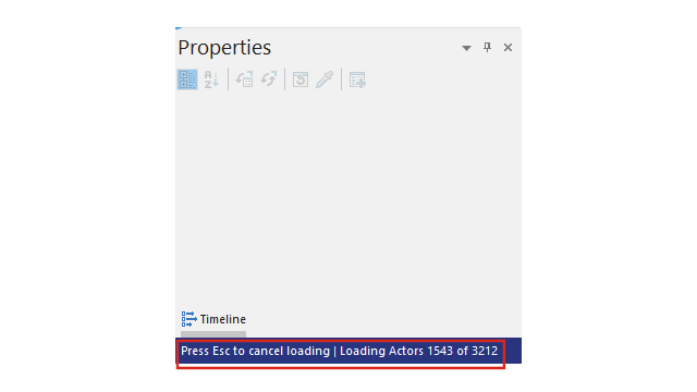

The loading process is improved for Composer documents such as
.smg, .smgXML, .smgProj, and fully
shattered files.
Available in SOLIDWORKS Composer.
- The loading status appears in the left-hand side of the status
bar.
- During the loading process, you can press Escape to cancel the operation. This does not
affect already-opened files.
See Importing and
Opening Files > Importing and Opening Files in Composer Help.
