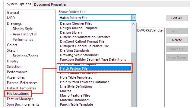

To specify a new location for the hatch pattern file:
- Move your modified sldwks.ptn file to the location of your choice.
- Click Options
(Standard toolbar) or .
- On the System Options tab, click File Locations.
- In Show folders for, select Hatch Pattern File.
- Select the current location of the hatch pattern file and click Delete.
- To specify the new location, click Add, browse to the new location, and click OK.
