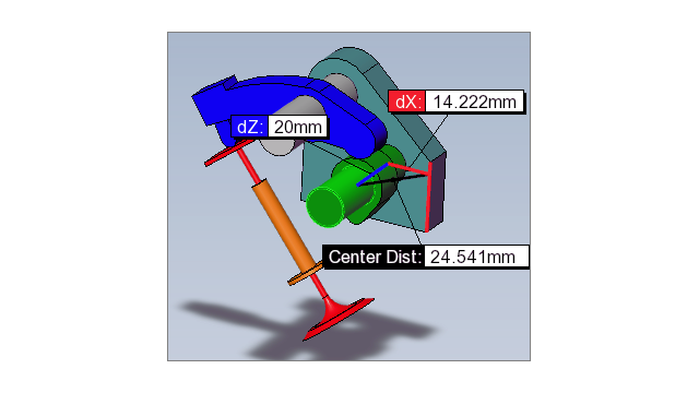

You can use the Measure
tool to measure distances between planar-cylindrical and cylindrical-cylindrical faces.
Different options specify the distance to measure when you select arcs or
circles.
Click
Measure
, and select:
- A planar face and a cylindrical face. The normal distance is
displayed.
- Two cylindrical faces. In the Measure pane, under Arc/Circle
Measurements, specify Distance as Center to
Center, Minimum Distance,
or Maximum Distance.
