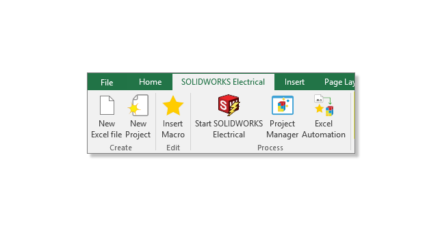

You can install an
Excel® add-in that helps create data for the
Excel Automation feature (requires Excel
64-bit edition).
To install this add-in, from SOLIDWORKS
Electrical Schematic, click
and
select Install Excel add-in.
If the installation does not start
automatically, in the dialog box, select EwExcelAddIn.vsto.
