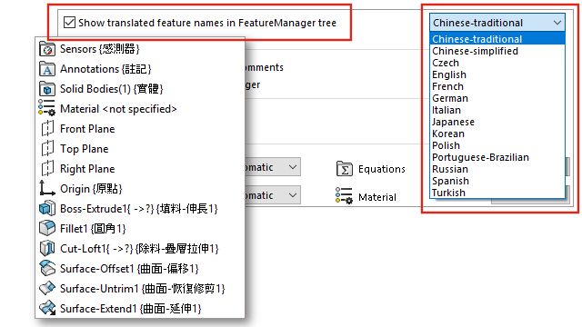

You can use a system option to show translated features names in
the
FeatureManager® design tree.
Click . Select Show translated feature names in
FeatureManager tree and select a language.
This option replaces the Show Translated
Feature Name in Tooltip option under Tree
Display.
