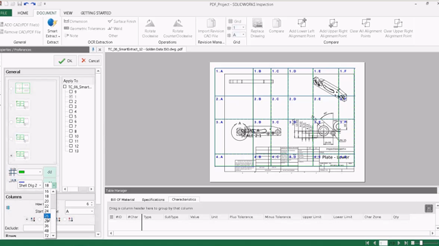

Grid Improvements
You can customize grids to help you quickly identify their characteristics.
You can:
  • Change the font style and size of zone markers.
  • Display dashed gridlines to be less obtrusive and reduce interference with dimensions.
  • Adjust column width and row height independently. This helps users create inspection documents from legacy PDF files that might not have equally spaced columns or rows.
