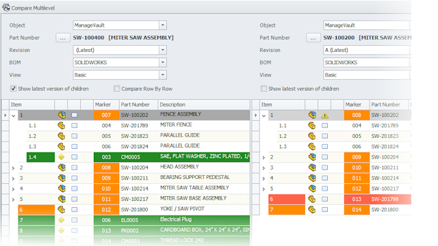

- You can compare all the levels of BOMs by specifying the
Multi-line compare option in the
Bill
of Materials (BOM) compare tool.
