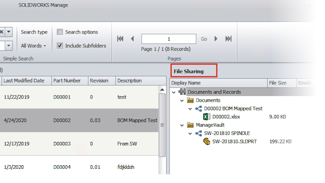

You can share files from SOLIDWORKS Manage with anyone, even if
they do not have SOLIDWORKS Manage installed.
To share a file, right-click and select
Share. You can then edit settings for each
shared file from the File Sharing tab in both the
desktop and the Plenary web client interface.
The Share command creates a special link to the files through the Plenary
web client. You can copy, email, and password protect this link. You can also define a
time limit after which the link becomes invalid.
Administrators enable sharing for users
and groups and define limits on the number of files that can be shared simultaneously.
They can also define the number of links that can be created for a particular object.
