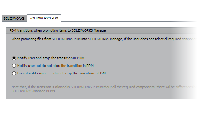

You
can select the options that are available to define the handling of missing file
references during promotion through SOLIDWORKS PDM state change.
The
options are:
- Notify
user and stop the transition in SOLIDWORKS
PDM. This is the default
behavior.
- Notify
user and continue the transition in SOLIDWORKS
PDM
- Do
not notify user and continue the transition in SOLIDWORKS
PDM
If you
select this option, it
may result in differences between SOLIDWORKS PDM and
SOLIDWORKS Manage BOMs.
