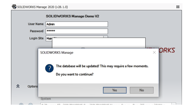

When
you upgrade a client and log in to the environment, SOLIDWORKS
Manage
lets you optionally upgrade the
database.
If you choose not to
upgrade the database, the database remains unchanged and you cannot use it with the
upgraded client. Previously, when you upgraded the client, the database upgraded
automatically too.
