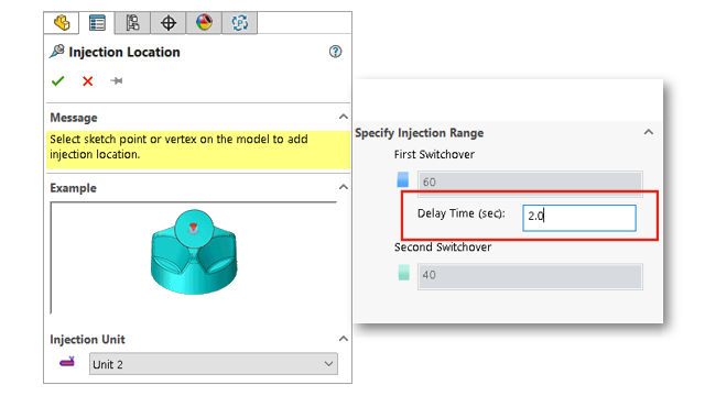

can specify a delay time between injections of the first and second material for
Co-injection, Gas-assist, and Water-assist processes.
The image shows a
setting for a Gas-assist injection molding process. The cavity is filled to 60% capacity
with polymer when the switch to nitrogen gas is initialized. The gas injection begins
after a
2-second
time delay.
