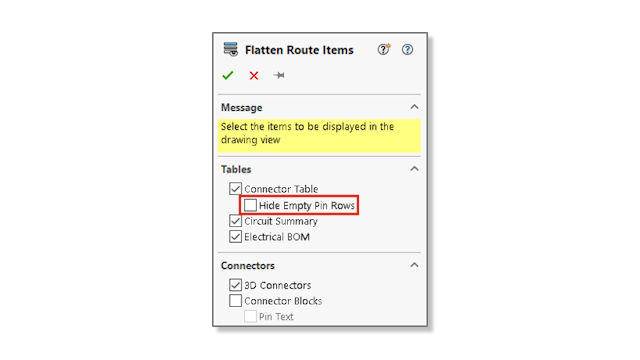

Hiding Empty Pin Rows You can hide unused pins in flattened routes. In the Flatten Route Items PropertyManager, select the Hide Empty Pin Rows. Parent topicRouting Routing Multiple Wires Through Clips Location of Tables in Flattened Routes Table Properties in Flattened Routes Selecting Several Routes for Electrical Attributes Keeping Cable Ends at Correct Pin Locations Locking Route Segments Propagating Termination Type Additional Properties Available in the BOMs Splicing Without Components Selecting Components to Maintain 3D Orientation in Flatten Routes
