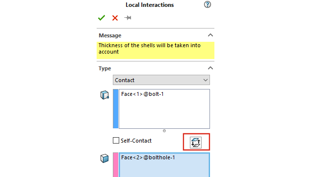

For local interactions, you can switch the geometry selections between
the source and target sets to resolve convergence issues. When you are working with
complex geometries that have multiple faces, switching the geometry entities between the
source and target sets with the Swap interaction faces tool saves
you time.
In the Local Interactions PropertyManager,
click Swap interaction faces
