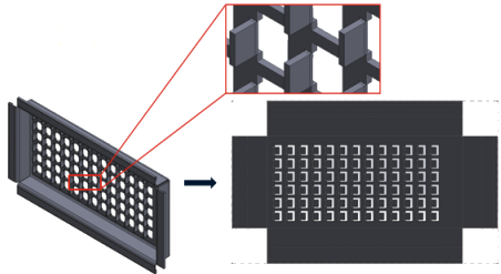

Sheet metal:
- Flat pattern corner treatments use updated
algorithms to correctly identify corner geometry and apply
appropriate corner treatments to avoid sharp cuts and
notches.
- Fixed issues for mirrored and derived parts to
create proper corner treatments.

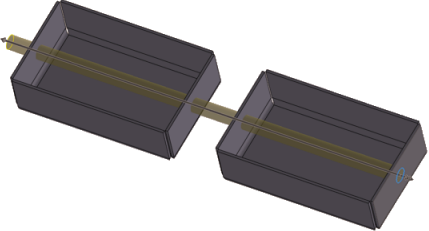

- Assembly features can propagate to individual
components even if there are multiple instances of the same part
in the assembly. Sheet metal parts created in SOLIDWORKS 2013
and later did not support this functionality.
