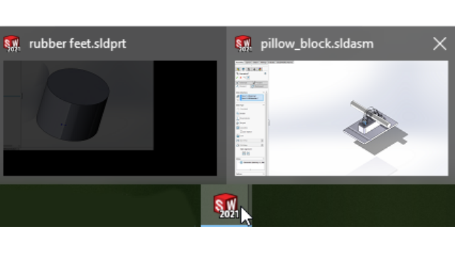

When you have multiple windows open and you hover over the
SOLIDWORKS®
icon in the
taskbar, the window with an open PropertyManager shows as the active
thumbnail.
You must close the PropertyManager before you can select a different window.
In
some cases, an open PropertyManager
does not prevent you from switching windows. All thumbnails are active when you
hover over the icon.
