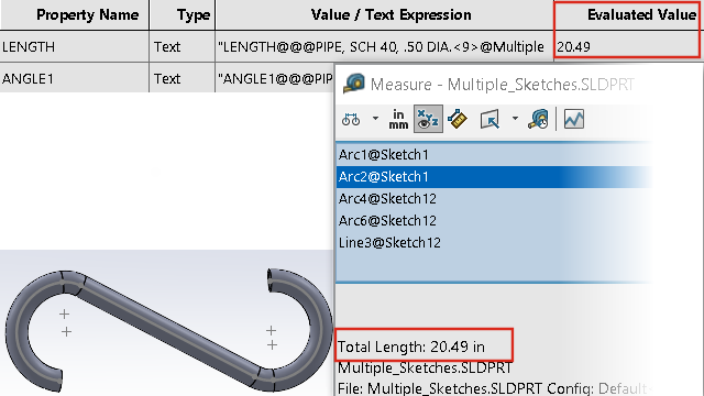

You can calculate the
correct cut list length of a weldment member in the cut list
properties.
correct length when you:
- Use a
Move Face or Move/Copy Body feature and then extrude a cut or
a hole
- Create the part that contains multiple sketches by selecting
Merge miter trimmed bodies
- Create an extruded cut or hole that modifies multiple faces
across groups
