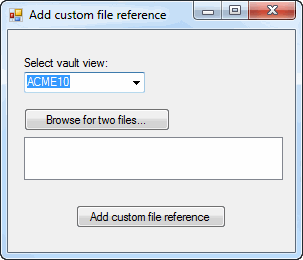

// 1. Displays the Add custom file reference dialog box.
//    a. Select a vault view.
//    b. Click Browse for two files
//       1. Locate and click two files in the root folder of the vault.
//       2. Click Open.
//       3. Checks out the first file.
//    c. Click Add custom file reference.
//    d. Click OK to close each message box.
// 2. Close the Add custom file reference dialog.

            this.Text = "Add custom file reference";
