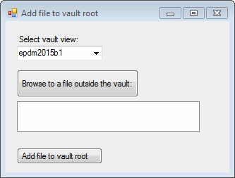

Add File Example (C#)
This example shows how to add a file outside the vault to the vault root.
NOTE: If using the primary interop assembly provided with SOLIDWORKS PDM Professional, see Using .NET Framework 4.0 in Stand-alone Applications.
// Preconditions:
// 1. Start Microsoft Visual Studio.
//    a. Click File > New > Project > Visual C# > Windows Forms Application.
//    b. Type AddFiles in Name.
//    c. Click Browse and navigate to the folder where to create
//       the project.
//    d. Click OK
//    e. Click Show All Files in the Solution Explorer toolbar and expand
//       Form1.cs in the Solution Explorer.
//    f. Replace the code in Form1.cs with this code.
//    g. To create the form, replace the code in Form1.Designer.cs with this code.
// 2. Add EPDM.Interop.epdm.dll as a reference (right-click the project
//    name in the Solution Explorer, click Add Reference, click
//    Assemblies > Framework in the left-side panel, browse to the top folder of
//    your SOLIDWORKS PDM Professional installation, locate and click
//    EPDM.Interop.epdm.dll, click Open, and click Add).
// 3. Add EPDM.Interop.EPDMResultCode.dll as a reference (click Browse, locate and
//    click EPDM.Interop.EPDMResultCode.dll, click Open, click Add, and click Close).
// 4. Right-click EPDM.Interop.epdm in References, click Properties, and set
//    Embed Interop Types to False to handle methods that pass arrays of
//    structures.
// 5. Run the Administration tool, log in as admin, expand the vault,
//    right-click File Types, click Duplicate file name settings, and
//    click Do not allow duplicate files names in this file vault.
// 6  Ensure that at least one file exists in a subfolder in the vault and
//    the same-named file exists outside the vault.
// 7. Click Debug > Start Debugging or press F5.
// Postconditions:
// 1. Displays the Add file to vault root dialog box.
//    a. Select a vault view.
//    b. Click Browse to a file outside the vault
//       1. Locate a file outside the vault that exists in
//          a subfolder in the vault.
//       2. Click Open.
//    c. Click Add file to vault root to add the selected file to the
//       root folder of the vault.
//    d. Displays a message box warning you that the selected file is not
//       unique in the vault, but that the file will be added to the vault root.
//    e. Click OK.
// 2. Close the Add file to vault root dialog box.
// 3. Examine the vault root.

            // Form1
            this.AutoScaleDimensions = new System.Drawing.SizeF(6F, 13F);
            this.AutoScaleMode = System.Windows.Forms.AutoScaleMode.Font;
            this.ClientSize = new System.Drawing.Size(317, 215);
            this.Controls.Add(this.AddFiles);
            this.Controls.Add(this.ListBox);
            this.Controls.Add(this.BrowseButton);
            this.Controls.Add(this.VaultsComboBox);
            this.Controls.Add(this.VaultsLabel);
            this.Name = "Form1";
            this.Text = "Add file to vault root";
            this.Load += new System.EventHandler(this.Form1_Load);
            this.ResumeLayout(false);
            this.PerformLayout();
        #endregion
        internal System.Windows.Forms.Label VaultsLabel;
        internal System.Windows.Forms.ComboBox VaultsComboBox;
        internal System.Windows.Forms.Button BrowseButton;
        internal System.Windows.Forms.ListBox ListBox;
        internal System.Windows.Forms.Button AddFiles;
        internal System.Windows.Forms.OpenFileDialog OpenFileDialog;
