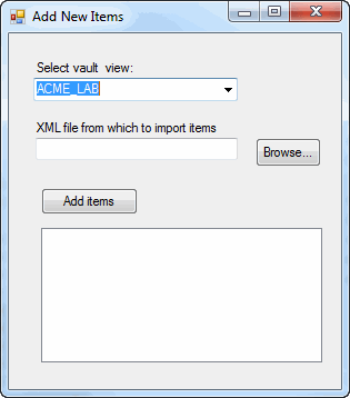

This example shows how to add items to a vault. The data for the items is imported from an XML file, which is read by the .NET XmlReader.
NOTE: If using the primary interop assembly provided with SOLIDWORKS PDM Professional, see Using .NET Framework 4.0 in Stand-alone Applications.

'     f. Create a form similar to the form shown above and change:
'        1. Top label to VaultsLabel.
'        2. Combo box to VaultsComboBox.
'        3. Second label to XmlLabel.
'        4. Text box to XmlTextBox.
'        5. Browse button to BrowseButton.
'        6. Add items button to AddItemsButton.
'        7. List box to ItemsListBox.

'  1. Displays a dialog.
'  2. Select a vault.
'  3. Click the Browse button, locate and click Items.xml, and click Open.
'  4. Click the Add items button.
'     The new items are printed in the dialog's list.
'  5. Close the dialog.

   Private Sub InitializeComponent()
        Me.BrowseButton = New System.Windows.Forms.Button()
        Me.XmlTextBox = New System.Windows.Forms.TextBox()
        Me.XmlLabel = New System.Windows.Forms.Label()
        Me.XmlOpenFileDialog = New System.Windows.Forms.OpenFileDialog()
        Me.AddItemsButton = New System.Windows.Forms.Button()
        Me.VaultsComboBox = New System.Windows.Forms.ComboBox()
        Me.VaultsLabel = New System.Windows.Forms.Label()
        Me.ItemsListBox = New System.Windows.Forms.ListBox()
        Me.SuspendLayout()
        'BrowseButton
        Me.BrowseButton.Location = New System.Drawing.Point(222, 94)
        Me.BrowseButton.Margin = New System.Windows.Forms.Padding(2)
        Me.BrowseButton.Name = "BrowseButton"
        Me.BrowseButton.Size = New System.Drawing.Size(59, 26)
        Me.BrowseButton.TabIndex = 0
        Me.BrowseButton.Text = "Browse..."
        Me.BrowseButton.UseVisualStyleBackColor = True
        'XmlTextBox
        Me.XmlTextBox.Location = New System.Drawing.Point(24, 94)
        Me.XmlTextBox.Margin = New System.Windows.Forms.Padding(2)
        Me.XmlTextBox.Name = "XmlTextBox"
        Me.XmlTextBox.Size = New System.Drawing.Size(182, 20)
        Me.XmlTextBox.TabIndex = 1
        'XmlLabel
        Me.XmlLabel.AutoSize = True
        Me.XmlLabel.Location = New System.Drawing.Point(22, 78)
        Me.XmlLabel.Margin = New System.Windows.Forms.Padding(2, 0, 2, 0)
        Me.XmlLabel.Name = "XmlLabel"
        Me.XmlLabel.Size = New System.Drawing.Size(172, 13)
        Me.XmlLabel.TabIndex = 2
        Me.XmlLabel.Text = "XML file from which to import items:"
        'XmlOpenFileDialog
        Me.XmlOpenFileDialog.Filter = "XML files|*.xml"
        'AddItemsButton
        Me.AddItemsButton.Location = New System.Drawing.Point(29, 139)
        Me.AddItemsButton.Margin = New System.Windows.Forms.Padding(2)
        Me.AddItemsButton.Name = "AddItemsButton"
        Me.AddItemsButton.Size = New System.Drawing.Size(87, 24)
        Me.AddItemsButton.TabIndex = 3
        Me.AddItemsButton.Text = "Add items"
        Me.AddItemsButton.UseVisualStyleBackColor = True
        'VaultsComboBox
        Me.VaultsComboBox.FormattingEnabled = True
        Me.VaultsComboBox.Location = New System.Drawing.Point(22, 40)
        Me.VaultsComboBox.Margin = New System.Windows.Forms.Padding(2)
        Me.VaultsComboBox.Name = "VaultsComboBox"
        Me.VaultsComboBox.Size = New System.Drawing.Size(184, 21)
        Me.VaultsComboBox.TabIndex = 12
        'VaultsLabel
        Me.VaultsLabel.AutoSize = True
        Me.VaultsLabel.Location = New System.Drawing.Point(22, 24)
        Me.VaultsLabel.Margin = New System.Windows.Forms.Padding(2, 0, 2, 0)
        Me.VaultsLabel.Name = "VaultsLabel"
        Me.VaultsLabel.Size = New System.Drawing.Size(94, 13)
        Me.VaultsLabel.TabIndex = 13
        Me.VaultsLabel.Text = "Select vault  view:"
        'ItemsListBox
        Me.ItemsListBox.FormattingEnabled = True
        Me.ItemsListBox.Location = New System.Drawing.Point(29, 175)
        Me.ItemsListBox.Margin = New System.Windows.Forms.Padding(2)
        Me.ItemsListBox.Name = "ItemsListBox"
        Me.ItemsListBox.Size = New System.Drawing.Size(253, 121)
        Me.ItemsListBox.TabIndex = 14
        'AddItems
        Me.AutoScaleDimensions = New System.Drawing.SizeF(6.0!, 13.0!)
        Me.AutoScaleMode = System.Windows.Forms.AutoScaleMode.Font
        Me.ClientSize = New System.Drawing.Size(299, 320)
        Me.Controls.Add(Me.ItemsListBox)
        Me.Controls.Add(Me.VaultsComboBox)
        Me.Controls.Add(Me.VaultsLabel)
        Me.Controls.Add(Me.AddItemsButton)
        Me.Controls.Add(Me.XmlLabel)
        Me.Controls.Add(Me.XmlTextBox)
        Me.Controls.Add(Me.BrowseButton)
        Me.Margin = New System.Windows.Forms.Padding(2)
        Me.Name = "AddItems"
        Me.Text = "Add New Items"
        Me.ResumeLayout(False)
        Me.PerformLayout()
    End Sub
