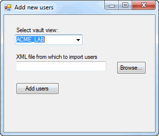

'  2. Start Microsoft Visual Studio.
'     a. Click File > New > Project > Visual Basic > Windows Forms Application.
'     b. Type AddUsers in Name.
'     c. Click Browse and navigate to the folder where to create
'        the project.
'     d. Click OK
'     e. Click Show All Files in the Solution Explorer toolbar and expand
'        Form1.vb in the Solution Explorer.
'     f. Create a form similar to the form shown above and change:
'        1. Top label to VaultsLabel.
'        2. Combo box to VaultsComboBox.
'        3. Second label to XmlLabel.
'        4. Text box to XmlTextBox.
'        5. Browse button to BrowseButton.
'        6. Add users button to AddUsersButton.
'     g. Replace the code in Form1.vb with this code.
'     h. Replace the code in Form1.Designer.vb with this code.

'  1. Displays a dialog.
'  2. Select a vault.
'  3. Click Browse, locate and click User.xml, and click Open.
'  4. Click Add users.
'     A message box is displayed showing the names and IDs of the new users added
'     to the vault.
'  5. Click OK to close the message box.
'  6. Close the dialog.

        Me.VaultsLabel.Location = New System.Drawing.Point(22, 24)
        Me.VaultsLabel.Margin = New System.Windows.Forms.Padding(2, 0, 2, 0)
        Me.VaultsLabel.Name = "VaultsLabel"
        Me.VaultsLabel.Size = New System.Drawing.Size(91, 13)
        Me.VaultsLabel.TabIndex = 13
        Me.VaultsLabel.Text = "Select vault view:"
        'AddUsers
        Me.AutoScaleDimensions = New System.Drawing.SizeF(6.0!, 13.0!)
        Me.AutoScaleMode = System.Windows.Forms.AutoScaleMode.Font
        Me.ClientSize = New System.Drawing.Size(304, 237)
        Me.Controls.Add(Me.VaultsComboBox)
        Me.Controls.Add(Me.VaultsLabel)
        Me.Controls.Add(Me.AddUsersButton)
        Me.Controls.Add(Me.XmlLabel)
        Me.Controls.Add(Me.XmlTextBox)
        Me.Controls.Add(Me.BrowseButton)
        Me.Margin = New System.Windows.Forms.Padding(2)
        Me.Name = "AddUsers"
        Me.Text = "Add new users"
        Me.ResumeLayout(False)
        Me.PerformLayout()
    End Sub
    Friend WithEvents BrowseButton As System.Windows.Forms.Button
    Friend WithEvents XmlTextBox As System.Windows.Forms.TextBox
    Friend WithEvents XmlLabel As System.Windows.Forms.Label
    Friend WithEvents XmlOpenFileDialog As System.Windows.Forms.OpenFileDialog
    Friend WithEvents AddUsersButton As System.Windows.Forms.Button
    Friend WithEvents VaultsComboBox As System.Windows.Forms.ComboBox
    Friend WithEvents VaultsLabel As System.Windows.Forms.Label
End Class
