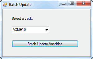

// Postconditions:
//  1. Displays the Batch Update dialog box.
//     a. Select a vault.
//     b. Click Batch Update Variables.
//        * Updates the Title and Comment variables in the data cards
//          only of checked-out text files.
//        * Updates the Description variable of the data cards of all folders
//          with the word Folder in their names.
//        * Displays a message box saying Card variables updated.
//     c. Click OK to close the message box.
//  2. Close the Batch Update dialog box.
//  3. Inspect the data cards of any checked-out text files and folders with
//     the word Folder in their names in the selected vault.

            //BatchUpdateButton
            this.BatchUpdateButton.Location = new System.Drawing.Point(30, 100);
            this.BatchUpdateButton.Name = "BatchUpdateButton";
            this.BatchUpdateButton.Size = new System.Drawing.Size(215, 23);
            this.BatchUpdateButton.TabIndex = 0;
            this.BatchUpdateButton.Text = "Batch Update Variables";
            this.BatchUpdateButton.UseVisualStyleBackColor = true;
            this.BatchUpdateButton.Click += new System.EventHandler(this.BatchUpdateButton_Click);
            //VaultsComboBox
            this.VaultsComboBox.FormattingEnabled = true;
            this.VaultsComboBox.Location = new System.Drawing.Point(30, 56);
            this.VaultsComboBox.Name = "VaultsComboBox";
            this.VaultsComboBox.Size = new System.Drawing.Size(121, 21);
            this.VaultsComboBox.TabIndex = 1;
            //Label1
            this.Label1.AutoSize = true;
            this.Label1.Location = new System.Drawing.Point(27, 23);
            this.Label1.Name = "Label1";
            this.Label1.Size = new System.Drawing.Size(91, 13);
            this.Label1.TabIndex = 2;
            this.Label1.Text = "Select vault view:";
