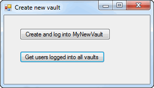

' Postconditions:
' 1. Displays the Create new vault dialog box.
'    a. Click Create and log in to MyNewVault.
'    b. After a few seconds, displays a login dialog.
'    c. Type Admin's password in Password.
'    d. Click Log in.
'       1. MyNewVault is created using the Default configuration in the root
'          folder of the archive server.
'       2. A view of MyNewVault, accessible to all users, is created in c:\temp.
'       3. Admin is logged into MyNewVault.
'    e. Click Get users logged into all vaults
'    f. Displays a dialog with all of the users currently logged into
'       vault views on this machine.
'    g. Click OK.
' 2. Close the Create new vault dialog box.
