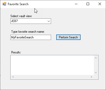

// 19. Click Debug > Start Debugging or press F5.
// // Postconditions:  //  1. Displays a dialog.
//  2. Select a vault. // 3. Type in a favorite search name.
//  4. Click Perform Search.
//  5. Displays search results, including the custom search column, Description.
//  6. Close the dialog.
