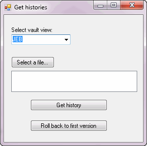

' Postconditions:
' 1. Displays the Get histories dialog box.
'    a. Select a vault view.
'    b. Click Select a file.
'    c. In the Select File dialog:
'       1. Select a checked-in vault file.
'       2. Click Open.
'       3. Updates all version comments for the selected file to
'          "New comment".
'    d. Click Get history.
'    e. Displays a message box for each history item.
'    f. Observe the updated version comments.
'    g. Click OK to close each message box.
'    h. Click Roll back to first version.
'       Rolls back the selected file to its first version.
'    i. Click Get history.
'       A message box displays one history item.
' 2. Close the Get histories dialog box.

'Form1.Designer.vb
<Global.Microsoft.VisualBasic.CompilerServices.DesignerGenerated()> _
Partial Class Form1
    Inherits System.Windows.Forms.Form
    'Form overrides dispose to clean up the component list.
    <System.Diagnostics.DebuggerNonUserCode()> _
    Protected Overrides Sub Dispose(ByVal disposing As Boolean)
        Try
            If disposing AndAlso components IsNot Nothing Then
                components.Dispose()
            End If
        Finally
            MyBase.Dispose(disposing)
        End Try
    End Sub
    'Required by the Windows Form Designer
    Private components As System.ComponentModel.IContainer
    'NOTE: The following procedure is required by the Windows Form Designer
    'It can be modified using the Windows Form Designer.
    'Do not modify it using the code editor.
    <System.Diagnostics.DebuggerStepThrough()> _
    Private Sub InitializeComponent()
        Me.VaultsLabel = New System.Windows.Forms.Label()
        Me.VaultsComboBox = New System.Windows.Forms.ComboBox()
        Me.SelectFiles = New System.Windows.Forms.Button()
        Me.File1List = New System.Windows.Forms.ListBox()
        Me.GetHistories = New System.Windows.Forms.Button()
        Me.OpenFileDialog1 = New System.Windows.Forms.OpenFileDialog()
        Me.Rollback = New System.Windows.Forms.Button()
        Me.SuspendLayout()
        'VaultsLabel
        Me.VaultsLabel.AutoSize = True
        Me.VaultsLabel.Location = New System.Drawing.Point(12, 24)
        Me.VaultsLabel.Name = "VaultsLabel"
        Me.VaultsLabel.Size = New System.Drawing.Size(91, 13)
        Me.VaultsLabel.TabIndex = 0
        Me.VaultsLabel.Text = "Select vault view:"
        'VaultsComboBox
        Me.VaultsComboBox.FormattingEnabled = True
        Me.VaultsComboBox.Location = New System.Drawing.Point(15, 40)
        Me.VaultsComboBox.Name = "VaultsComboBox"
        Me.VaultsComboBox.Size = New System.Drawing.Size(121, 21)
        Me.VaultsComboBox.TabIndex = 1
        'SelectFiles
        Me.SelectFiles.Location = New System.Drawing.Point(15, 85)
        Me.SelectFiles.Name = "SelectFiles"
        Me.SelectFiles.Size = New System.Drawing.Size(88, 23)
        Me.SelectFiles.TabIndex = 2
        Me.SelectFiles.Text = "Select a file..."
        Me.SelectFiles.UseVisualStyleBackColor = True
        'File1List
        Me.File1List.FormattingEnabled = True
        Me.File1List.HorizontalScrollbar = True
        Me.File1List.Location = New System.Drawing.Point(15, 114)
        Me.File1List.Name = "File1List"
        Me.File1List.Size = New System.Drawing.Size(257, 43)
        Me.File1List.TabIndex = 4
        'GetHistories
        Me.GetHistories.Location = New System.Drawing.Point(54, 172)
        Me.GetHistories.Name = "GetHistories"
        Me.GetHistories.Size = New System.Drawing.Size(157, 23)
        Me.GetHistories.TabIndex = 6
        Me.GetHistories.Text = "Get history"
        Me.GetHistories.UseVisualStyleBackColor = True
        'OpenFileDialog1
        Me.OpenFileDialog1.FileName = "OpenFileDialog1"
        Me.OpenFileDialog1.Multiselect = False
        Me.OpenFileDialog1.Title = "Select File"
        'Rollback
        Me.Rollback.Location = New System.Drawing.Point(54, 214)
        Me.Rollback.Name = "Rollback"
        Me.Rollback.Size = New System.Drawing.Size(157, 23)
        Me.Rollback.TabIndex = 7
        Me.Rollback.Text = "Roll back to first version"
        Me.Rollback.UseVisualStyleBackColor = True
        'Form1
        Me.AutoScaleDimensions = New System.Drawing.SizeF(6.0!, 13.0!)
        Me.AutoScaleMode = System.Windows.Forms.AutoScaleMode.Font
        Me.ClientSize = New System.Drawing.Size(284, 259)
        Me.Controls.Add(Me.Rollback)
        Me.Controls.Add(Me.GetHistories)
        Me.Controls.Add(Me.File1List)
        Me.Controls.Add(Me.SelectFiles)
        Me.Controls.Add(Me.VaultsComboBox)
        Me.Controls.Add(Me.VaultsLabel)
