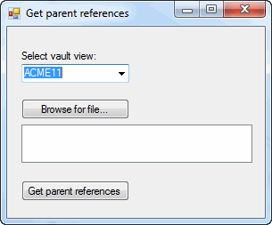

// Postconditions:
// 1. The Get parent references dialog displays.
// 2. Select a vault view.
// 3. Click Browse for file.
// 4. Locate and click one of the parts mentioned in Preconditions step 4.
// 5. Click Open.
// 6. Click Get parent references.
// 7. Displays the references of the selected part.
// 8. Click OK.
// 9. Close the Get parent references dialog.

        private void InitializeComponent()
            this.VaultsLabel = new System.Windows.Forms.Label();
            this.VaultsComboBox = new System.Windows.Forms.ComboBox();
            this.BrowseButton = new System.Windows.Forms.Button();
            this.Listbox = new System.Windows.Forms.ListBox();
            this.GetParentReferences = new System.Windows.Forms.Button();
            this.OpenFileDialog = new System.Windows.Forms.OpenFileDialog();
            this.SuspendLayout();
            //VaultsLabel
            this.VaultsLabel.AutoSize = true;
            this.VaultsLabel.Location = new System.Drawing.Point(13, 26);
            this.VaultsLabel.Name = "VaultsLabel";
            this.VaultsLabel.Size = new System.Drawing.Size(91, 13);
            this.VaultsLabel.TabIndex = 0;
            this.VaultsLabel.Text = "Select vault view:";
            //VaultsComboBox
            this.VaultsComboBox.FormattingEnabled = true;
            this.VaultsComboBox.Location = new System.Drawing.Point(16, 42);
            this.VaultsComboBox.Name = "VaultsComboBox";
            this.VaultsComboBox.Size = new System.Drawing.Size(121, 21);
            this.VaultsComboBox.TabIndex = 1;
            //BrowseButton
            this.BrowseButton.Location = new System.Drawing.Point(16, 81);
            this.BrowseButton.Name = "BrowseButton";
            this.BrowseButton.Size = new System.Drawing.Size(121, 23);
            this.BrowseButton.TabIndex = 3;
            this.BrowseButton.Text = "Browse for file...";
            this.BrowseButton.UseVisualStyleBackColor = true;
            this.BrowseButton.Click +=new System.EventHandler(BrowseButton_Click);
            //Listbox
            this.Listbox.FormattingEnabled = true;
            this.Listbox.HorizontalScrollbar = true;
            this.Listbox.Location = new System.Drawing.Point(16, 110);
            this.Listbox.Name = "Listbox";
            this.Listbox.Size = new System.Drawing.Size(259, 43);
            this.Listbox.TabIndex = 4;
            //GetParentReferences
            this.GetParentReferences.Location = new System.Drawing.Point(16, 173);
            this.GetParentReferences.Name = "GetParentReferences";
            this.GetParentReferences.Size = new System.Drawing.Size(121, 23);
            this.GetParentReferences.TabIndex = 5;
            this.GetParentReferences.Text = "Get parent references";
            this.GetParentReferences.UseVisualStyleBackColor = true;
            this.GetParentReferences.Click +=new System.EventHandler(GetParentReferences_Click);
            //Form1
            this.AutoScaleDimensions = new System.Drawing.SizeF(6f, 13f);
            this.AutoScaleMode = System.Windows.Forms.AutoScaleMode.Font;
            this.ClientSize = new System.Drawing.Size(289, 215);
            this.Controls.Add(this.GetParentReferences);
            this.Controls.Add(this.Listbox);
            this.Controls.Add(this.BrowseButton);
            this.Controls.Add(this.VaultsComboBox);
            this.Controls.Add(this.VaultsLabel);
            this.Name = "Form1";
            this.Text = "Get parent references";
            this.Load +=new System.EventHandler(Form1_Load);
            this.ResumeLayout(false);
            this.PerformLayout();
        #endregion
