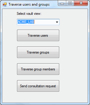

//  1. Displays a dialog.
//  2. Select a vault.
//  3. Click Traverse users.
//     Three message boxes report:
//     * users
in the vault,
//     * state permissions for a user in the vault,
//       - and -
//     * transition permissions for a user in the vault.
//  4. Click OK to close each message box.
//  5. Click Traverse groups.
//     A message box reports the groups in the vault.
//  6. Click OK to close the message box.
//  7. Click Traverse group members.
//     A message box reports the users of each group in the vault.
//  8. Click OK to close the message box.
//  9. Click Send consultation request.
//     After several minutes, a SOLIDWORKS PDM Professional notification
//     appears only to logged-in users.
// 10. To open the the message, click:
//     * the notification while it is displayed,
//     * the SOLIDWORKS PDM Professional tray icon,
//       - or -
//     * Tools > Inbox in the vault view.
// 11. Close the dialog.

            this.TraverseUsersButton.TabIndex = 2;
            this.TraverseUsersButton.Text = "Traverse users";
            this.TraverseUsersButton.UseVisualStyleBackColor = true;
            this.TraverseUsersButton.Click += new System.EventHandler(this.TraverseUsersButton_Click);
            // TraverseGroupsButton
            this.TraverseGroupsButton.Location = new System.Drawing.Point(29, 151);
            this.TraverseGroupsButton.Name = "TraverseGroupsButton";
            this.TraverseGroupsButton.Size = new System.Drawing.Size(168, 39);
            this.TraverseGroupsButton.TabIndex = 3;
            this.TraverseGroupsButton.Text = "Traverse groups";
            this.TraverseGroupsButton.UseVisualStyleBackColor = true;
            this.TraverseGroupsButton.Click += new System.EventHandler(this.TraverseGroupsButton_Click);
            // TraverseGroupMembersButton
            this.TraverseGroupMembersButton.Location = new System.Drawing.Point(29, 210);
            this.TraverseGroupMembersButton.Name = "TraverseGroupMembersButton";
            this.TraverseGroupMembersButton.Size = new System.Drawing.Size(168, 41);
            this.TraverseGroupMembersButton.TabIndex = 4;
            this.TraverseGroupMembersButton.Text = "Traverse group members";
            this.TraverseGroupMembersButton.UseVisualStyleBackColor = true;
            this.TraverseGroupMembersButton.Click += new System.EventHandler(this.TraverseGroupMembersButton_Click);
            // SendConsultationRequestButton
            this.SendConsultationRequestButton.Location = new System.Drawing.Point(29, 279);
            this.SendConsultationRequestButton.Name = "SendConsultationRequestButton";
            this.SendConsultationRequestButton.Size = new System.Drawing.Size(168, 35);
            this.SendConsultationRequestButton.TabIndex = 5;
            this.SendConsultationRequestButton.Text = "Send consultation request";
            this.SendConsultationRequestButton.UseVisualStyleBackColor = true;
            this.SendConsultationRequestButton.Click += new System.EventHandler(this.SendConsultationRequestButton_Click);
            // Form1
            this.AutoScaleDimensions = new System.Drawing.SizeF(6F, 13F);
            this.AutoScaleMode = System.Windows.Forms.AutoScaleMode.Font;
            this.ClientSize = new System.Drawing.Size(284, 342);
            this.Controls.Add(this.SendConsultationRequestButton);
            this.Controls.Add(this.TraverseGroupMembersButton);
            this.Controls.Add(this.TraverseGroupsButton);
            this.Controls.Add(this.TraverseUsersButton);
            this.Controls.Add(this.VaultsComboBox);
            this.Controls.Add(this.VaultsLabel);
            this.Name = "Form1";
            this.Text = "Traverse users and groups";
            this.Load += new System.EventHandler(this.UsersAndGroupsCSharp_Load);
            this.ResumeLayout(false);
            this.PerformLayout();
