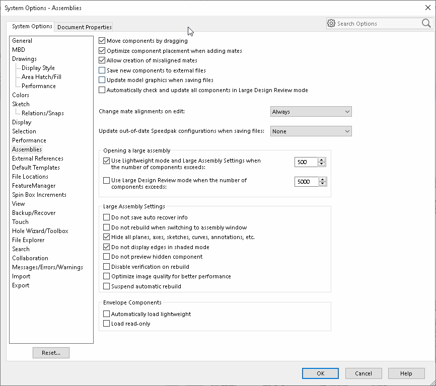

This topic contains two tables. The information in the table:
  • appearing immediately after the screen capture corresponds to the settings on that dialog.
  • titled Obsolete Enumerators contains enumerators that previously appeared on the dialog but are now obsolete.
Setting
Get/Set Method
Return Value
or
<Value>
or
<OnFlag>
Comment
Move components by dragging
ISldWorks::GetUserPreferenceToggle(swUserPreferenceToggle_e.swAssemblyAllowComponentMoveByDragging)
ISldWorks::SetUserPreferenceToggle(swUserPreferenceToggle_e.swAssemblyAllowComponentMoveByDragging, <OnFlag>)
Boolean value
Specifies whether to move assembly components by dragging them or using the Move with Triad and Move Component tools
Optimize component placement when adding mates
ISldWorks::GetUserPreferenceToggle(swUserPreferenceToggle_e.swOptimizeMatePlacement)
ISldWorks::SetUserPreferenceToggle(swUserPreferenceToggle_e.swOptimizeMatePlacement, <OnFlag>)
Boolean value
Allow creation of misaligned mates
ISldWorks::GetUserPreferenceToggle(swUserPreferenceToggle_e.swAssemblyAllowCreationOfMisalignedMates)
ISldWorks::SetUserPreferenceToggle(swUserPreferenceToggle_e.swAssemblyAllowCreationOfMisalignedMates, <OnFlag>)
Boolean value
Specifies whether to allow the creation of misaligned mates in assemblies
Save new components to external files
ISldWorks::GetUserPreferenceToggle(swUserPreferenceToggle_e.swSaveNewComponentsToExternalFile)
ISldWorks::SetUserPreferenceToggle(swUserPreferenceToggle_e.swSaveNewComponentsToExternalFile, <OnFlag>)
Boolean value
Specifies whether to save new components to external files
Not supported in SOLIDWORKS Connected
Update model graphics when saving files
ISldWorks::GetUserPreferenceToggle(swUserPreferenceToggle_e.swAssemblyUpdateModelGraphicsWhenSavingFiles)
ISldWorks::SetUserPreferenceToggle(swUserPreferenceToggle_e.swAssemblyUpdateModelGraphicsWhenSavingFiles, <OnFlag>)
Boolean value
Specifies whether to update model graphics when saving files
Automatically check and update all components in Large Design Review
ISldWorks::GetUserPreferenceToggle(swUserPreferenceToggle_e.swLargeAsmModeAutoCheckUpdateAllComponents)
ISldWorks::SetUserPreferenceToggle(swUserPreferenceToggle_e.swLargeAsmModeAutoCheckUpdateAllComponents, <OnFlag>)
Boolean value
Specifies whether to automatically check and update all components in Large Design Review
Allow graphics component
ISldWorks::GetUserPreferenceToggle(swUserPreferenceToggle_e.swAssemblyAllowGraphicsComponent)
ISldWorks::SetUserPreferenceToggle(swUserPreferenceToggle_e.swAssemblyAllowGraphicsComponent, <OnFlag>)
Boolean value
Valid only if registry setting, "Software\\SolidWorks\\SOLIDWORKS\\version\\Assemblies\\ShowAllGraphics, is set to true
Change mate alignments on edit
ISldWorks::GetUserPreferenceIntegerValue(swUserPreferenceIntegerValue_e.swEnableAutoMateFlip)
ISldWorks::SetUserPreferenceIntegerValue(swUserPreferenceIntegerValue_e.swEnableAutoMateFlip, <Value>)
  • 0 = Prompt
  • 1 = Always
  • 2 = Never
Update out-of-date Speedpak configurations when saving files
ISldWorks::GetUserPreferenceIntegerValue(swUserPreferenceIntegerValue_e.swUpdateOutOfDateSpeedPakConfigOnSave)
ISldWorks::SetUserPreferenceIntegerValue(swUserPreferenceIntegerValue_e.swUpdateOutOfDateSpeedPakConfigOnSave, swSpeedpakUpdate_e.<Value>)
Integer value as defined in swSpeedpakUpdate_e
Specifies under what conditions to update out-of-date Speedpak configurations when saving files
Opening large assemblies - Use Large Assembly Mode to improve performance when the assembly contains more than this number of components
(Not supported in SOLIDWORKS Connected)
ISldWorks::GetUserPreferenceToggle(swUserPreferenceToggle_e.swLargeAsmModeEnabled)
ISldWorks::SetUserPreferenceToggle(swUserPreferenceToggle_e.swLargeAsmModeEnabled, <OnFlag>)
ISldWorks::GetUserPreferenceIntegerValue(swUserPreferenceIntegerValue_e.swLargeAsmModeThreshold)
ISldWorks::SetUserPreferenceIntegerValue(swUserPreferenceIntegerValue_e.swLargeAsmModeThreshold, <Value>)
Boolean value
Integer value
Specifies whether to activate Large Assembly Mode
Specifies the minimum number of components in an assembly for automatically using Large Assembly Mode
Opening large assemblies - Use Large Design Review when the assembly contains more than this number of components
ISldWorks::GetUserPreferenceToggle(swUserPreferenceToggle_e.swLargeAsmModeLargeDesignReview)
ISldWorks::SetUserPreferenceToggle(swUserPreferenceToggle_e.swLargeAsmModeLargeDesignReview, <OnFlag>)
ISldWorks::GetUserPreferenceIntegerValue(swUserPreferenceIntegerValue_e.swLargeAsmModeLargeDesignReviewThreshhold)
ISldWorks::SetUserPreferenceIntegerValue(swUserPreferenceIntegerValue_e.swLargeAsmModeLargeDesignReviewThreshhold, <Value>)
Boolean value
Integer value
Specifies whether to automatically use Large Design Review based on the number of components in the assembly; see swLargeAsmModeLargeDesignReviewThreshhold
Specifies the minimum number of components in an assembly for automatically using Large Design Review
When Large Assembly Mode is active - Do not save auto recover info
ISldWorks::GetUserPreferenceToggle(swUserPreferenceToggle_e.swLargeAsmModeAutoRecover)
ISldWorks::SetUserPreferenceToggle(swUserPreferenceToggle_e.swLargeAsmModeAutoRecover, <OnFlag>)
Boolean value
Specifies whether to automatically save model information after specified number of changes
When Large Assembly Mode is active - Do not rebuild when switching to assembly window
ISldWorks::GetUserPreferenceToggle(swUserPreferenceToggle_e.swLargeAsmModeDismissAutoUpdate)
ISldWorks::SetUserPreferenceToggle(swUserPreferenceToggle_e.swLargeAsmModeDismissAutoUpdate, <OnFlag>)
Boolean value
Specifies whether to rebuild when switching to the assembly window
When Large Assembly Mode is active - Hide all planes, axes, sketches, curves, annotations, etc.
ISldWorks::GetUserPreferenceToggle(swUserPreferenceToggle_e.swLargeAsmModeHideAllItems)
ISldWorks::SetUserPreferenceToggle(swUserPreferenceToggle_e.swLargeAsmModeHideAllItems, <OnFlag>)
Boolean value
Specifies whether to hide all planes, axes, sketches, curves, annotations, etc.
When Large Assembly Mode is active - Do not display edges in shaded mode
ISldWorks::GetUserPreferenceToggle(swUserPreferenceToggle_e.swLargeAsmModeUseHLREdgesInShaded)
ISldWorks::SetUserPreferenceToggle(swUserPreferenceToggle_e.swLargeAsmModeUseHLREdgesInShaded, <OnFlag>)
Boolean value
Specifies whether to use HLR edges in shaded mode
When Large Assembly Mode is active - Do not preview hidden component
ISldWorks::GetUserPreferenceToggle(swUserPreferenceToggle_e.swLargeAsmModePreviewHiddenComponent)
ISldWorks::SetUserPreferenceToggle(swUserPreferenceToggle_e.swLargeAsmModePreviewHiddenComponent, <OnFlag>)
Boolean value
Specifies whether to not preview hidden components
When Large Assembly Mode is active - Disable verification on rebuild
ISldWorks::GetUserPreferenceToggle(swUserPreferenceToggle_e.swLargeAsmModeVerificationOnRebuild)
ISldWorks::SetUserPreferenceToggle(swUserPreferenceToggle_e.swLargeAsmModeVerificationOnRebuild, <OnFlag>)
Boolean value
Specifies whether to disable verification on rebuild
When Large Assembly Mode is active - Optimize image quality for better performance
ISldWorks::GetUserPreferenceToggle(swUserPreferenceToggle_e.swLargeAsmModeImageQualityPerformance)
ISldWorks::SetUserPreferenceToggle(swUserPreferenceToggle_e.swLargeAsmModeImageQualityPerformance, <OnFlag>)
Boolean value
Specifies whether to optimize image quality for better performance
When Large Assembly Mode is active - Suspend automatic rebuild
ISldWorks::GetUserPreferenceToggle(swUserPreferenceToggle_e.swLargeAsmModeSuspendAutoRebuild)
ISldWorks::SetUserPreferenceToggle(swUserPreferenceToggle_e.swLargeAsmModeSuspendAutoRebuild, <OnFlag>)
Boolean value
Specifies whether to suspend automatic rebuilds
Envelope Components - Automatically load lightweight
ISldWorks::GetUserPreferenceToggle(swUserPreferenceToggle_e.swLoadEnvelopeLightweight)
ISldWorks::SetUserPreferenceToggle(swUserPreferenceToggle_e.swLoadEnvelopeLightweight, <OnFlag>)
Boolean value
Specifies whether to automatically load envelope components in lightweight mode
Envelope Components - Load read-only
ISldWorks::GetUserPreferenceToggle(swUserPreferenceToggle_e.swLoadEnvelopeReadOnly)
ISldWorks::SetUserPreferenceToggle(swUserPreferenceToggle_e.swLoadEnvelopeReadOnly, <OnFlag>)
Boolean value
Specifies whether to load envelope components in read-only mode
