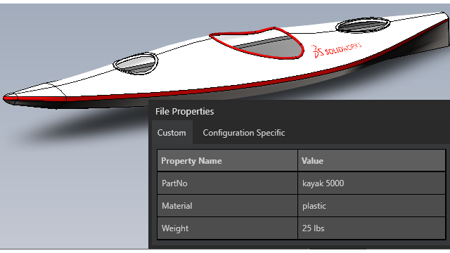

You can
view the custom and configuration-specific properties of SOLIDWORKS files in
eDrawings.
Configuration-specific data is available for the last-saved configuration and for
configurations where you selected Add Display Data Mark in
SOLIDWORKS, for SLDPRT and SLDASM files
only.
To view file
properties:
Click or File Properties
