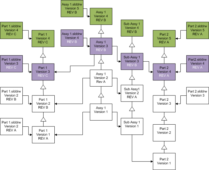

Moving Existing Revision Tags
You can move the latest revision tag to the latest version of a file you are upgrading.
Selections represented In the diagram below are:
Screen Option Selections
Search Files to Upgrade Files of type <All SW file types>
Version Settings Create new version of files Files referencing older versions
  • Are excluded
Update revisions
  • Move revision
Files before upgrade, showing revision that is moved
Upgraded files
