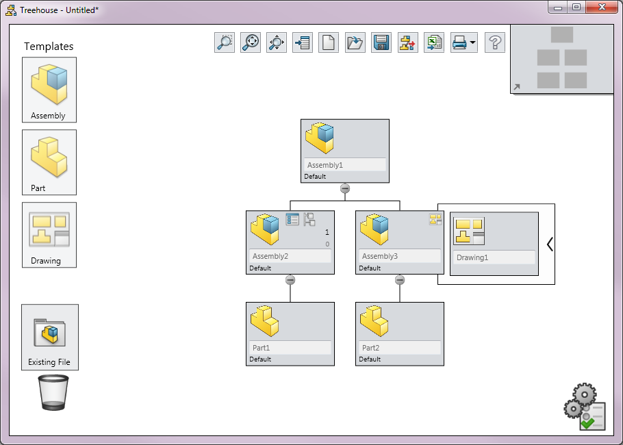

In Treehouse, you can set up your assembly hierarchy in a graphical user interface before you build your models in the SOLIDWORKS software. You can add to an existing file structure in Treehouse.

In Treehouse you can:
  • Drag part, assembly, and drawing nodes into the graphics area to create a file structure.
  • Edit file properties.
  • Add configurations.
  • Suppress components and component instances.
  • Drag existing documents into Treehouse from Microsoft® File Explorer.
