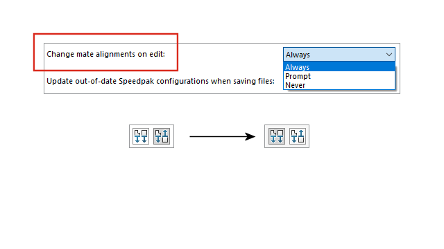

When you flip the
alignment of a mate, the edited mate flips.
In Assemblies
system options, select Change mate alignments on
edit to warn you when mate changes result in errors that can be avoided
by flipping the mate alignment. Specify Always,
Prompt, or Never to determine when you receive the warning.
Change mate alignments on edit is
renamed from Prompt before changing mate alignments on
edit.
