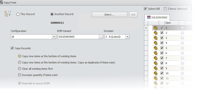

| Copy
From |
Click Copy
From and use the Copy
From dialog box to
view
the structure of the selected record and also
select the items that you want to copy. |
