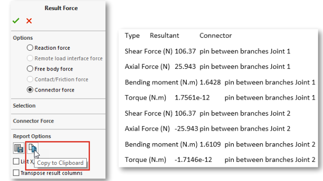

You can copy tabular simulation results displayed inside
PropertyManagers
to the clipboard and paste the copied
data
from the clipboard into a
Microsoft®
Excel® or Word
document.
You can copy reaction forces, free body forces, contact/friction forces, connector
forces, and probed results.
In a PropertyManager that contains
simulation results, under Report Options, select
Copy to Clipboard
