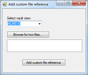

' Postconditions:
' 1. Displays the Add custom file reference dialog box.
'    a. Select a vault view.
'    b. Click Browse for two files
'       1. Locate and click two files in the root folder of the vault.
'       2. Click Open.
'       3. Checks out the first file.
'    c. Click Add custom file reference.
'    d. Click OK to close each message box.
' 2. Close the Add custom file reference dialog.

        Me.Controls.Add(Me.VaultsComboBox)
        Me.Controls.Add(Me.VaultsLabel)
        Me.Name = "Form1"
        Me.Text = "Add custom file reference"
