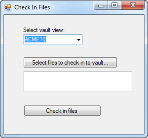

// 1. Displays the Check In Files dialog box.
//    a. Select a vault view.
//    b. Click Select files to check out from vault.
//    c. In the Select File dialog:
//       1. Click the checked-out vault file.
//       2. Click Open.
//    d. Click Check in files.
//    e. Displays the Check in dialog box with the Reload or Close Files
//       after Check In
dropdown in the toolbar.
//    f. Click the Check in button.
//    g. Click OK in the message box.
// 2. Close the Check In Files dialog box.
// 3. Observe that the selected file is checked in to the selected vault.

        private void InitializeComponent()
            this.VaultsLabel = new System.Windows.Forms.Label();
            this.VaultsComboBox = new System.Windows.Forms.ComboBox();
            this.SelectFiles = new System.Windows.Forms.Button();
            this.File1List = new System.Windows.Forms.ListBox();
            this.BatchUnlock = new System.Windows.Forms.Button();
            this.OpenFileDialog1 = new System.Windows.Forms.OpenFileDialog();
            this.SuspendLayout();
            //VaultsLabel
            this.VaultsLabel.AutoSize = true;
            this.VaultsLabel.Location = new System.Drawing.Point(36, 24);
            this.VaultsLabel.Name = "VaultsLabel";
            this.VaultsLabel.Size = new System.Drawing.Size(91, 13);
            this.VaultsLabel.TabIndex = 0;
            this.VaultsLabel.Text = "Select vault view:";
            //VaultsComboBox
            this.VaultsComboBox.FormattingEnabled = true;
            this.VaultsComboBox.Location = new System.Drawing.Point(39, 40);
            this.VaultsComboBox.Name = "VaultsComboBox";
            this.VaultsComboBox.Size = new System.Drawing.Size(121, 21);
            this.VaultsComboBox.TabIndex = 1;
            //SelectFiles
            this.SelectFiles.Location = new System.Drawing.Point(39, 85);
            this.SelectFiles.Name = "SelectFiles";
            this.SelectFiles.Size = new System.Drawing.Size(191, 23);
            this.SelectFiles.TabIndex = 2;
            this.SelectFiles.Text = "Select files to check in to vault...";
            this.SelectFiles.UseVisualStyleBackColor = true;
            this.SelectFiles.Click += new System.EventHandler(SelectFiles_Click);
            //File1List
            this.File1List.FormattingEnabled = true;
            this.File1List.HorizontalScrollbar = true;
            this.File1List.Location = new System.Drawing.Point(40, 114);
            this.File1List.Name = "File1List";
            this.File1List.SelectionMode = System.Windows.Forms.SelectionMode.MultiExtended;
            this.File1List.Size = new System.Drawing.Size(220, 43);
            this.File1List.TabIndex = 4;
            //BatchUnlock
            this.BatchUnlock.Location = new System.Drawing.Point(40, 183);
            this.BatchUnlock.Name = "BatchUnlock";
            this.BatchUnlock.Size = new System.Drawing.Size(157, 23);
            this.BatchUnlock.TabIndex = 6;
            this.BatchUnlock.Text = "Check in files";
            this.BatchUnlock.UseVisualStyleBackColor = true;
            this.BatchUnlock.Click += new System.EventHandler(this.BatchUnlock_Click);
            //OpenFileDialog1
            this.OpenFileDialog1.FileName = "OpenFileDialog1";
            this.OpenFileDialog1.Multiselect = true;
            this.OpenFileDialog1.Title = "Select File";
            //Form1
            this.AutoScaleDimensions = new System.Drawing.SizeF(6f, 13f);
            this.AutoScaleMode = System.Windows.Forms.AutoScaleMode.Font;
            this.ClientSize = new System.Drawing.Size(284, 242);
            this.Controls.Add(this.BatchUnlock);
            this.Controls.Add(this.File1List);
            this.Controls.Add(this.SelectFiles);
            this.Controls.Add(this.VaultsComboBox);
            this.Controls.Add(this.VaultsLabel);
            this.Name = "Form1";
            this.Text = "Check In Files";
            this.Load += new System.EventHandler(this.Form1_Load);
            this.ResumeLayout(false);
            this.PerformLayout();
        internal System.Windows.Forms.Label VaultsLabel;
        internal System.Windows.Forms.ComboBox VaultsComboBox;
        internal System.Windows.Forms.Button SelectFiles;
        internal System.Windows.Forms.ListBox File1List;
        internal System.Windows.Forms.Button BatchUnlock;
        internal System.Windows.Forms.OpenFileDialog OpenFileDialog1;
