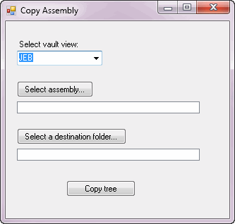

' 1. Displays the Copy Assembly dialog box.
'    a. Select a vault view.
'    b. Click Select assembly
'       Locate and double-click an assembly.
'    c. Click Select a destination folder.
'       1. Locate and select New Folder.
'       2. Click OK.
'    d. Click Copy tree.
'       The Copy Tree dialog shows the files to copy.
'    e. Click Copy
'       The Copying tree progress bar appears.
'    f. Inspect the destination folder.
' 2. Close the Copy Assembly dialog box.

        Me.VaultsLabel = New System.Windows.Forms.Label()
        Me.VaultsComboBox = New System.Windows.Forms.ComboBox()
        Me.BrowseAssembly = New System.Windows.Forms.Button()
        Me.ListBox = New System.Windows.Forms.ListBox()
        Me.CopyTree = New System.Windows.Forms.Button()
        Me.OpenFileDialog = New System.Windows.Forms.OpenFileDialog()
        Me.BrowseDestFolder = New System.Windows.Forms.Button()
        Me.ListBox1 = New System.Windows.Forms.ListBox()
        Me.SuspendLayout()
        'VaultsLabel
        Me.VaultsLabel.AutoSize = True
        Me.VaultsLabel.Location = New System.Drawing.Point(13, 26)
        Me.VaultsLabel.Name = "VaultsLabel"
        Me.VaultsLabel.Size = New System.Drawing.Size(94, 13)
        Me.VaultsLabel.TabIndex = 0
        Me.VaultsLabel.Text = " Select vault view:"
        'VaultsComboBox
        Me.VaultsComboBox.FormattingEnabled = True
        Me.VaultsComboBox.Location = New System.Drawing.Point(16, 42)
        Me.VaultsComboBox.Name = "VaultsComboBox"
        Me.VaultsComboBox.Size = New System.Drawing.Size(121, 21)
        Me.VaultsComboBox.TabIndex = 1
        'BrowseAssembly
        Me.BrowseAssembly.Location = New System.Drawing.Point(16, 85)
        Me.BrowseAssembly.Name = "BrowseAssembly"
        Me.BrowseAssembly.Size = New System.Drawing.Size(108, 23)
        Me.BrowseAssembly.TabIndex = 3
        Me.BrowseAssembly.Text = "Select assembly..."
        Me.BrowseAssembly.UseVisualStyleBackColor = True
        'ListBox
        Me.ListBox.FormattingEnabled = True
        Me.ListBox.HorizontalScrollbar = True
        Me.ListBox.Location = New System.Drawing.Point(16, 114)
        Me.ListBox.Name = "ListBox"
        Me.ListBox.SelectionMode = System.Windows.Forms.SelectionMode.None
        Me.ListBox.Size = New System.Drawing.Size(259, 17)
        Me.ListBox.TabIndex = 4
        'CopyTree
        Me.CopyTree.Location = New System.Drawing.Point(86, 226)
        Me.CopyTree.Name = "CopyTree"
        Me.CopyTree.Size = New System.Drawing.Size(98, 23)
        Me.CopyTree.TabIndex = 5
        Me.CopyTree.Text = "Copy tree"
        Me.CopyTree.UseVisualStyleBackColor = True
        'OpenFileDialog
        Me.OpenFileDialog.Multiselect = True
        Me.OpenFileDialog.Title = "Open"
        'BrowseDestFolder
        Me.BrowseDestFolder.Location = New System.Drawing.Point(16, 152)
        Me.BrowseDestFolder.Name = "BrowseDestFolder"
        Me.BrowseDestFolder.Size = New System.Drawing.Size(155, 23)
        Me.BrowseDestFolder.TabIndex = 6
        Me.BrowseDestFolder.Text = "Select a destination folder..."
        Me.BrowseDestFolder.UseVisualStyleBackColor = True
        'ListBox1
        Me.ListBox1.FormattingEnabled = True
        Me.ListBox1.Location = New System.Drawing.Point(16, 181)
        Me.ListBox1.Name = "ListBox1"
        Me.ListBox1.Size = New System.Drawing.Size(259, 17)
        Me.ListBox1.TabIndex = 7

        Me.Name = "Form1"
        Me.Text = "Copy Assembly"
        Me.ResumeLayout(False)
        Me.PerformLayout()
    End Sub
#End Region
    Friend WithEvents VaultsLabel As System.Windows.Forms.Label
    Friend WithEvents VaultsComboBox As System.Windows.Forms.ComboBox
    Friend WithEvents BrowseAssembly As System.Windows.Forms.Button
    Friend WithEvents ListBox As System.Windows.Forms.ListBox
    Friend WithEvents CopyTree As System.Windows.Forms.Button
    Friend WithEvents OpenFileDialog As System.Windows.Forms.OpenFileDialog
    Friend WithEvents BrowseDestFolder As Button
    Friend WithEvents ListBox1 As ListBox
End Class
