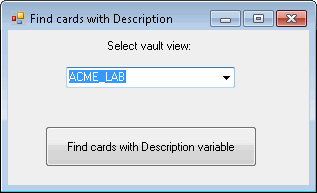

Find Data Cards with Description Variable Example (VB.NET)
This example shows how to find the data cards in your vault that have a Description variable.
NOTE: If using the primary interop assembly provided with SOLIDWORKS PDM Professional, see Using .NET Framework 4.0 in Stand-alone Applications.
' Preconditions:
'  1. Start Microsoft Visual Studio.
'  2. Click File > New > Project > Visual Basic > Windows Forms Application.
'  3. Type Exercise3 in Name.
'  4. Click the Browse button and browse to the folder where to create the project.
'  5. Click OK
'  6. Create a form similar to the form shown above and change:
'     a. Label to VaultsLabel.
'     b. Combo box to VaultsComboBox
'     c. Button to FindCardsButton.
'  7. Replace the code in Form1.vb with this code.
'  8. Replace the code in Form1.Designer.vb with this code.
'  9. Add EPDM.Interop.epdm.dll as a reference (right-click the project
'     name in the Solution Explorer, click Add Reference, click
'     Framework in the left-side panel, browse to the top folder of your
'     SOLIDWORKS PDM Professional installation, locate and click
'     EPDM.Interop.epdm.dll, click Open, click Add, and click Close).
' 10. Right-click EPDM.Interop.epdm in References, select Properties, and set
'     Embed Interop Types to False to handle methods that pass arrays of
'     structures.
' 11. Open the Immediate window.
' 12. Switch back to the Form1.vb code window.
' 13. Click Debug > Start Debugging or press F5.
' Postconditions:
'  1. Displays a dialog.
'  2. Select a vault.
'  3. Click the Find cards with Description variable button.
'     The cards in your vault with a Description variable are
'     printed to the Immediate window.
'  4. Examine the Immediate window.
'  5. Close the dialog.
