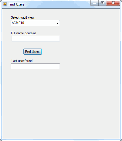

// Postconditions:
//  1. Displays the Find Users dialog box.
//     a. Select a vault view.
//     b. In Full name contains, type a substring of the full name of a
//        user that exists in the vault.
//     c. Click Find Users.
//        A message box confirms the substring typed in Postconditions
//        step 1b.
//     d. Click OK.
//        Displays a Search for users dialog.
//     e. Click Find.
//        Displays a Search for users dialog with results.
//     f. Click the first row.
//     g. Click Select.
//        * Displays a message box with the updated user information.
//        * The selected user's phone and website information are updated.
//     h. Click OK.
//  2. Updates the Find Users dialog box with the full name and picture,
//     if it exists, of the last user found whose full name contains the substring
//     typed in Postconditions step 1b.
//  3. Close the Find Users dialog box.

            // Form1
            this.AutoScaleDimensions = new System.Drawing.SizeF(6F, 13F);
            this.AutoScaleMode = System.Windows.Forms.AutoScaleMode.Font;
            this.ClientSize = new System.Drawing.Size(406, 447);
            this.Controls.Add(this.TextBox2);
            this.Controls.Add(this.Label3);
            this.Controls.Add(this.TextBox1);
            this.Controls.Add(this.Label2);
            this.Controls.Add(this.Label1);
            this.Controls.Add(this.VaultsComboBox);
            this.Controls.Add(this.FindUsers);
            this.Name = "Form1";
            this.Text = "Find Users";
            this.Load += new System.EventHandler(this.Form1_Load);
            this.ResumeLayout(false);
            this.PerformLayout();
