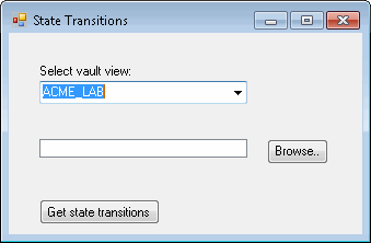

// 4. Ensure that the vault contains a file in a workflow state.
// 5. Click Debug > Start Debugging or press F5.
// Postconditions:
// 1. Displays the State Transitions dialog box.
// 2. Select a vault view.
// 3. Click Browse.
// 4. Displays the Select a file dialog box.
//    a. Select a file in the selected vault.
//    b. Click Open.
//    The selected file's path and file name appear
//    in the Select a file dialog box.
// 5. Click Get state transitions
// 6. Displays a message box showing the name of the selected
//    file and its current and next possible state transitions.
// 7. Click OK to close the message box.

            this.AutoScaleMode = System.Windows.Forms.AutoScaleMode.Font;
            this.ClientSize = new System.Drawing.Size(284, 200);
            this.Controls.Add(this.GetTransitionButton);
            this.Controls.Add(this.BrowseButton);
            this.Controls.Add(this.FileListBox);
            this.Controls.Add(this.VaultsComboBox);
            this.Controls.Add(this.VaultsLabel);
            this.Name = "Form1";
            this.Text = "Workflow State Transitions";
            this.ResumeLayout(false);
            this.PerformLayout();
            this.Load += new System.EventHandler(Form1_Load);
        #endregion
        private System.Windows.Forms.Label VaultsLabel;
        private System.Windows.Forms.ComboBox VaultsComboBox;
        private System.Windows.Forms.ListBox FileListBox;
        private System.Windows.Forms.Button BrowseButton;
        private System.Windows.Forms.Button GetTransitionButton;
        private System.Windows.Forms.OpenFileDialog OpenFileDialog1;
