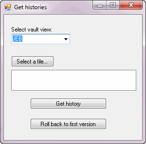

//  1. Displays the Get histories dialog box.
//     a. Select a vault view.
//     b. Click Select a file.
//     c. In the Select File dialog:
//        1. Select one or more checked-in vault files.
//        2. Click Open.
//        3. Updates all version comments for the selected files to
//           "New comment".
//     d. Click Get history.
//     e. Displays a message box for each history item.
//     f. Observe the updated version comments.
//     g. Click OK to close each message box.
//     h. Click Roll back to first version.
//        Rolls back the selected file to its first version.
//     i. Click Get history.
//        A message box displays one history item.
//  2. Close the Get histories dialog box.

            this.VaultsLabel = new System.Windows.Forms.Label();
            this.VaultsComboBox = new System.Windows.Forms.ComboBox();
            this.SelectFiles = new System.Windows.Forms.Button();
            this.File1List = new System.Windows.Forms.ListBox();
            this.GetHistories = new System.Windows.Forms.Button();
            this.OpenFileDialog1 = new System.Windows.Forms.OpenFileDialog();
            this.button1 = new System.Windows.Forms.Button();
            this.SuspendLayout();
            // VaultsLabel
            this.VaultsLabel.AutoSize = true;
            this.VaultsLabel.Location = new System.Drawing.Point(12, 24);
            this.VaultsLabel.Name = "VaultsLabel";
            this.VaultsLabel.Size = new System.Drawing.Size(91, 13);
            this.VaultsLabel.TabIndex = 0;
            this.VaultsLabel.Text = "Select vault view:";
            // VaultsComboBox
            this.VaultsComboBox.FormattingEnabled = true;
            this.VaultsComboBox.Location = new System.Drawing.Point(15, 40);
            this.VaultsComboBox.Name = "VaultsComboBox";
            this.VaultsComboBox.Size = new System.Drawing.Size(121, 21);
            this.VaultsComboBox.TabIndex = 1;
            // SelectFiles
            this.SelectFiles.Location = new System.Drawing.Point(15, 85);
            this.SelectFiles.Name = "SelectFiles";
            this.SelectFiles.Size = new System.Drawing.Size(88, 23);
            this.SelectFiles.TabIndex = 2;
            this.SelectFiles.Text = "Select a file...";
            this.SelectFiles.UseVisualStyleBackColor = true;
            this.SelectFiles.Click += new System.EventHandler(this.SelectFiles_Click);
            // File1List
            this.File1List.FormattingEnabled = true;
            this.File1List.HorizontalScrollbar = true;
            this.File1List.Location = new System.Drawing.Point(15, 114);
            this.File1List.Name = "File1List";
            this.File1List.Size = new System.Drawing.Size(257, 56);
            this.File1List.TabIndex = 4;
            // GetHistories
            this.GetHistories.Location = new System.Drawing.Point(64, 193);
            this.GetHistories.Name = "GetHistories";
            this.GetHistories.Size = new System.Drawing.Size(157, 23);
            this.GetHistories.TabIndex = 6;
            this.GetHistories.Text = "Get history";
            this.GetHistories.UseVisualStyleBackColor = true;
            this.GetHistories.Click += new System.EventHandler(this.GetHistories_Click);
            // OpenFileDialog1
            this.OpenFileDialog1.FileName = "OpenFileDialog1";
            this.OpenFileDialog1.Multiselect = false;
            this.OpenFileDialog1.Title = "Select File";
            // button1
            this.button1.Location = new System.Drawing.Point(64, 235);
            this.button1.Name = "button1";
            this.button1.Size = new System.Drawing.Size(157, 23);
            this.button1.TabIndex = 7;
            this.button1.Text = "Roll back to first version";
            this.button1.UseVisualStyleBackColor = true;
            this.button1.Click += new System.EventHandler(this.Rollback_Click);
            // Form1
            this.AutoScaleDimensions = new System.Drawing.SizeF(6F, 13F);
            this.AutoScaleMode = System.Windows.Forms.AutoScaleMode.Font;
            this.ClientSize = new System.Drawing.Size(284, 280);
            this.Controls.Add(this.button1);
            this.Controls.Add(this.GetHistories);
            this.Controls.Add(this.File1List);
            this.Controls.Add(this.SelectFiles);
            this.Controls.Add(this.VaultsComboBox);
            this.Controls.Add(this.VaultsLabel);
            this.Name = "Form1";
            this.Text = "Get histories";
            this.Load += new System.EventHandler(this.Form1_Load);
            this.ResumeLayout(false);
            this.PerformLayout();
        #endregion
        internal System.Windows.Forms.Label VaultsLabel;
        internal System.Windows.Forms.ComboBox VaultsComboBox;
        internal System.Windows.Forms.Button SelectFiles;
        internal System.Windows.Forms.ListBox File1List;
        internal System.Windows.Forms.Button GetHistories;
        internal System.Windows.Forms.OpenFileDialog OpenFileDialog1;
        private System.Windows.Forms.Button button1;
