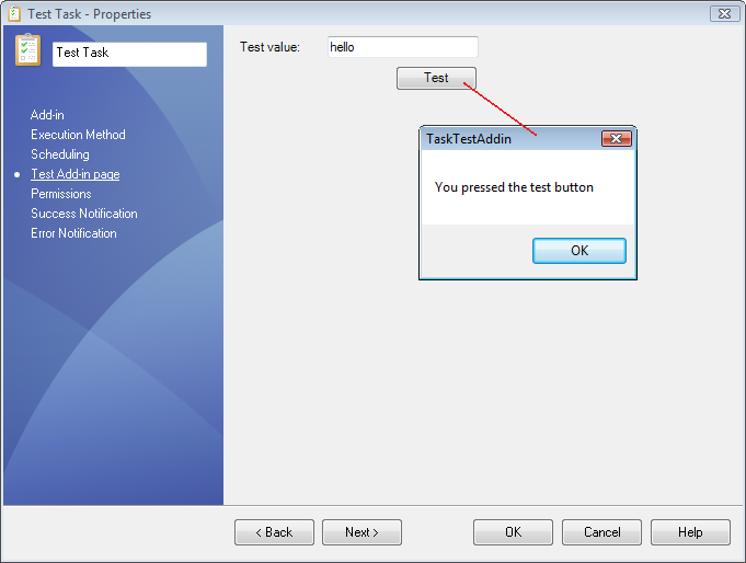

The following is a resource template of the custom set-up page that is displayed in the Task property dialog box by TaskAddIn::OnTaskSetup. It is a user control in Visual Studio with an edit box named TextBox1 and a button named TestButton.
The code behind the custom set-up page is as follows.
Imports EPDM.Interop.epdm
Public Class SetupPage
'Button handler for a button on the page
Private Sub TestButton_Click(ByVal sender As System.Object, ByVal e As System.EventArgs) Handles TestButton.Click
  MsgBox("You pressed the test button")
End Sub
Public Sub LoadData(ByRef poCmd As EdmCmd)
  'Get the property interface used to access the framework
  Dim props As IEdmTaskProperties
  props = poCmd.mpoExtra
  'Populate the edit box from a variable
TextBox1.Text = props.GetValEx("MyTestSetupVar")
End Sub
Public Sub StoreData(ByRef poCmd As EdmCmd)
  'Make sure the user has typed a value in the edit box
  If TextBox1.Text = "" Then
    MsgBox("Enter a test value for the add-in!")
    poCmd.mbCancel = True
    Exit Sub
  End If
  'Save the value entered by the user
  props.SetValEx("MyTestSetupVar", TextBox1.Text)
End Sub
End Class

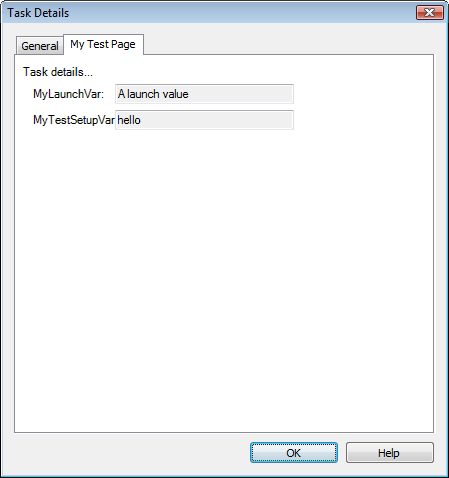

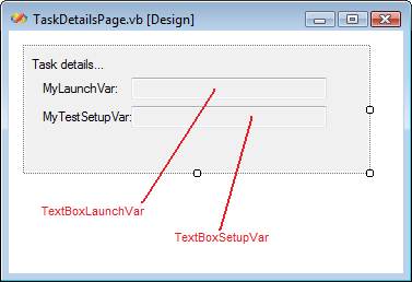

The following is the resource template of the extra details page added by TaskAddIn::OnTaskDetails. It is a user control in Visual Studio that displays two task variables:
The code behind the extra details page:
Public Class TaskDetailsPage
Public Sub LoadData(ByRef inst As IEdmTaskInstance)
  'Populate the editboxes from the variables in the task
  TextBoxSetupVar.Text = CStr(inst.GetValEx("MyTestSetupVar"))
  TextBoxLaunchVar.Text = CStr(inst.GetValEx("MyLaunchVar"))
End Sub
End Class

The following is the task details page when opened from the task list.

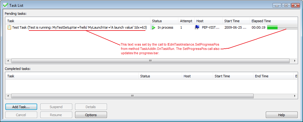

The following is the task list during task execution.
