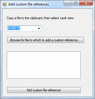

This example shows how to add a custom file reference to a
file in the vault.

// Preconditions:
// 1. Start Microsoft Visual Studio.
// a. Click File > New > Project > Visual
C# > Windows Forms Application.
// b. Type CustRefCSharp in Name.
// c. Click Browse and navigate to the folder where to create
// the project.
// d. Click OK.
// e. Click Show All Files in the Solution Explorer toolbar and expand
// Form1.cs in the Solution Explorer.
// f. Create a form similar to the form shown above and change:
// 1. Top label to VaultsLabel.
// 2. Combo box to VaultsComboBox.
// 3. Browse button to BrowseButton.
// 4. List box to CustRefListBox.
// 5. Add custom file reference button to AddCustomFileReference.
// g. Replace the code in Form1.cs with this code.
// h. Replace the code in Form1.Designer.cs with this code.
// 2. Add EPDM.Interop.epdm.dll as a reference (right-click the project
// name in the Solution Explorer, click Add Reference, click
// Assemblies > Framework in the left-side panel, browse to the top folder of
// your SOLIDWORKS PDM Professional installation, locate and click
// EPDM.Interop.epdm.dll, click Open, click Add, and click Close).
// 3. Right-click EPDM.Interop.epdm in References, click Properties, and set
// Embed Interop Types to False to handle methods that pass arrays of
// structures.
// 4. Click Debug > Start Debugging or press F5.
// Postconditions:
// 1. The Add custom references dialog displays.
// 2. Select a vault.
// 3. Click Browse for file to which to add custom reference,
// locate and click a file in the vault, and click Open.
// The file is checked out.
// 4. In a view of the selected vault, right-click a file and click Copy.
// 5. In the
Add custom references dialog, click Add custom file reference.
// The file that was copied to the clipboard is added as a custom
// reference to the checked-out file.
// 6. In the Create File References dialog, click OK.
// The file is checked in.
// 7. In the Edit User-Defined File References dialog, click OK.
// 8. Close the Add custom references dialog.
