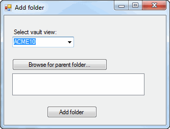

Add Folder Example (C#)
This example shows how to create a folder and set its data card and permissions.

// Postconditions:
// 1. Displays the Add folder dialog box.
//    a. Select a vault view.
//    b. Click Browse for parent folder
//       1. Locate and click a folder in the vault.
//       2. Click OK.
//    c. Click Add folder.
//       1.  Creates an IEdmFolderData5 object with:
//           * Folder user permissions for user, Engineer1.
//           * Folder group permissions for group, Administrators.
//           * File data card for .doc files.
//       2. Displays a message that folder, Temp, is added as a subfolder to
//          the folder clicked in Postconditions 1b1.
//       3. Click OK.
// 2. Close the Add folder dialog box.
// 3. Open File Explorer on a vault view and observe the new sub-folder,
//    Temp.
// 4. Open the Administration tool.
//    a. Log in to the vault selected in step 1a.
//    b. Expand Groups and double-click Administrators.
//    c. Click Folder Permissions.
//    d. Inspect the folder permissions for Temp and click OK.
//    e. Expand Users and double-click Engineer1.
//    f. Repeat steps 4c and 4d.
// 5. Exit the Administration tool.
