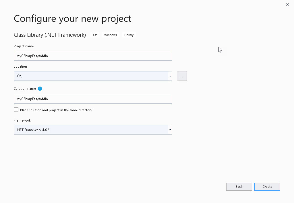

  • Select Visual C# -> Class Library (.NET Framework)
Click Next.
Click Create.

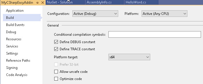

In the solution tree -> Go to project properties.
Verify that solution platform is x64
In the Build Events tab, In the Post-build events command line Add this comand line: C:\WINDOWS\Microsoft.NET\Framework64\$(frameworkversion)\regasm.exe "$(TargetPath)" /codebase

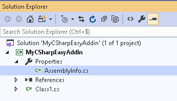

Open Assemblyinfo.cs:
Verify that you have ComVisible(true) and not ComVisible(false).

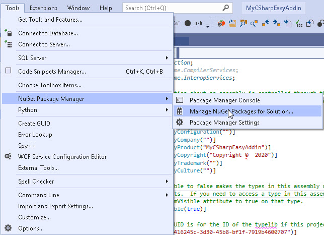

Go to "Tools->Manage Nuget Packages for Solution..."

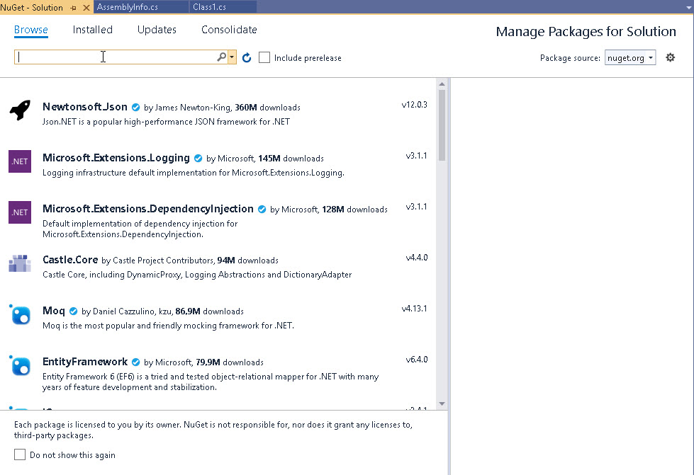

Select Package source: nuget.org.

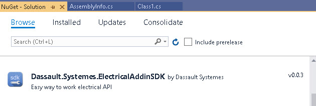

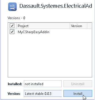

In Browse, Select ElectricalAddinSDK:
And click on "Install":

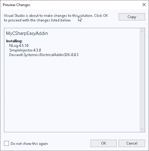

Click on "OK":

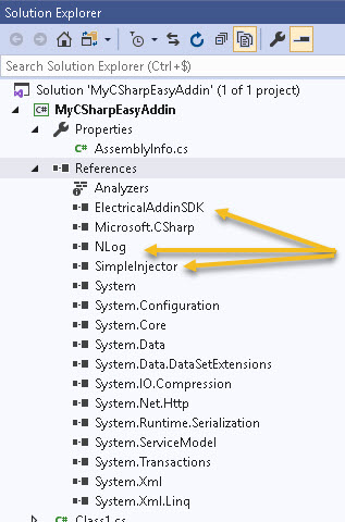

Check under References, if you see:
  • ElectricalAddinSDK
  • NLog
  • SimpleInjector

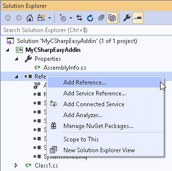

Right click on Reference and select Add reference...
Add EwAPI Browse to the location of EwAPIX.dll

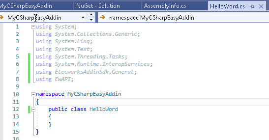

In your Class interface (HelloWorld.cs):
  • Add: using System.Runtime.InteropServices;
  • Add: using ElecworksAddinSdk.General;
  • Add: using EwAPI;
Like in screen shot below:

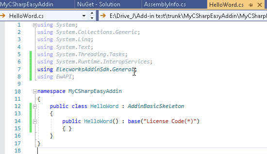

Create a main class which inherit AddinBasicSkeleton and implement mandatory methods
Finally add those methods to your main class to register this add-in:
